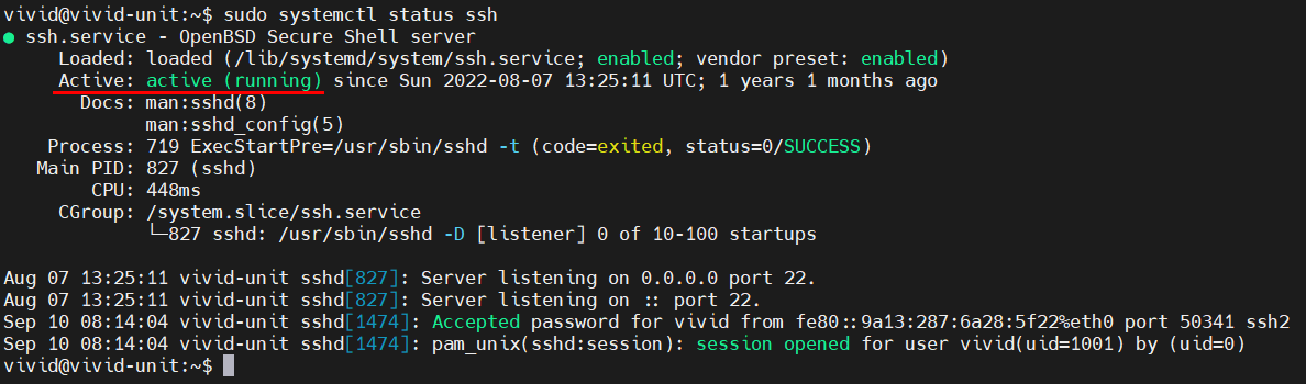

If you are not sure whether SSH is currently enabled, you can run this command to check it:
sudo systemctl status ssh
You will be able to see if the SSH server is currently running. The screenshot below gives an example of status for running SSH server, which means SSH is currently enabled.

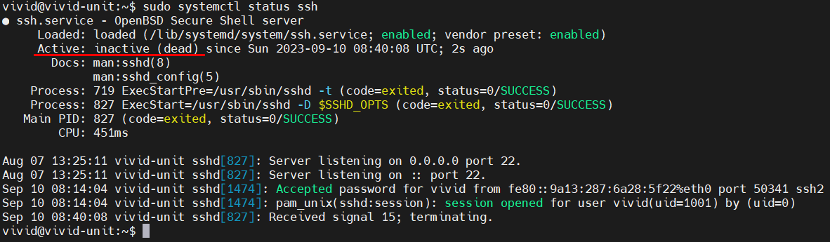

If you want to disable SSH until next reboot, you can stop the SSH server with this command:
sudo systemctl stop ssh
If you check the SSH server status again, you will see:
