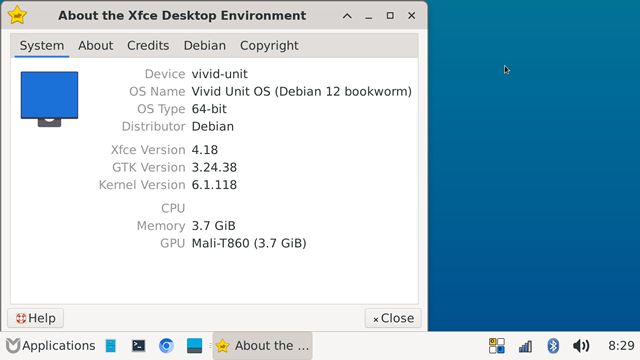

is an upgrade to Debian 12 (bookworm) possible?
Posted : 26/02/2024 1:46 pm
Posts: 850
It is planned and we are currently working on it.
Posted : 26/02/2024 2:06 pm

I am trying the update manually on the vivvid unit machine.
This is my "/etc/apt/sources" file now:
deb  http://deb.debian.org/debian/  bookworm main contrib non-free
deb-src  http://deb.debian.org/debian/  bookworm main contrib non-free
deb  http://deb.debian.org/debian-security/  bookworm-security main contrib non-free
deb-src  http://deb.debian.org/debian-security/  bookworm-security main contrib non-free
deb  http://deb.debian.org/debian/  bookworm-updates main contrib non-free
deb-src  http://deb.debian.org/debian/  bookworm-updates main contrib non-free
After "apt-get update" I try "apt-get upgrade" and furtheron "apt-get full-upgrade" with these results:
 sudo apt-get full-upgrade
Reading package lists... Done
Building dependency tree... Done
Reading state information... Done
Calculating upgrade... Done
The following packages were automatically installed and are no longer required:
  libcdio-cdda2 libcdio-paranoia2 libenca0 libldb2 liblirc-client0 liblmdb0
  libmng1 libsdl1.2debian libtalloc2 libtevent0 libvorbisidec1 libwbclient0
  libxvmc1 python3-ldb
Use 'sudo apt autoremove' to remove them.
The following packages have been kept back:

Posts: 850
@arodd @jockm @shirin-klees @andypiper
Hi everyone, thanks for the feedback (and yes, the frustration is understandable).
Vivid Unit started as a hardware-driven project, and we’ve been shipping a complete software stack on top of it -- but we acknowledge we haven’t communicated the OS maintenance status clearly enough, and some “how-to” steps were effectively hidden in forum replies. That’s on us.
Where we are today
The current shipping OS is Debian 11 (Bullseye). Some newer Debian packages and ecosystems have moved on, and that creates real pain for users who depend on newer libraries.
We are actively developing the next OS image based on Debian 12 (Bookworm). After that, we plan to move forward with Debian 13 (Trixie) when it makes sense and is stable for this device.
What you can expect from the new OS (screenshots below)
The new image is no longer “just a plan” — it’s in hands-on testing and polishing:
  • Bookworm-based system image (and a clear path forward).
  • Clean, minimal desktop layout.
  • GPU acceleration enabled by default (no more manual enable scripts for a normal setup).
  • New major versions:
    • VGP: major performance improvements.
    • VSA: adds gesture-based shortcuts for key functions.
    • VUE: updated to support the newly released Extender 2.
About source code / kernel / device tree / bootloader etc.
Some repos already exist on GitHub.
The whole buildable system will be hosted on GitHub when it is ready.
ETA
We don’t want to give a date that becomes a promise and then slips.
We are doing our best to get the new system online as soon as possible. We hope this will happen in the first half of 2026.
Posted : 09/02/2026 10:13 am
