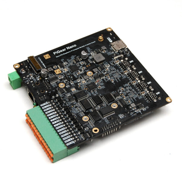

PiGear Nano is a Nano–ITX (12x12cm) carrier board for Raspberry Pi Compute Module 4.
SKU: PIGEAR_NANO Categories: , Tags: , , ,
PiGear Nano is a high performance Nano–ITX (12x12cm) carrier board for Raspberry Pi Compute Module 4. PiGear Nano is mainly designed for industrial applications, but you can also use it as office computer, family media center, gaming console etc.
PiGear Nano works with all models of Raspberry Pi Compute Module 4 (with or without eMMC).

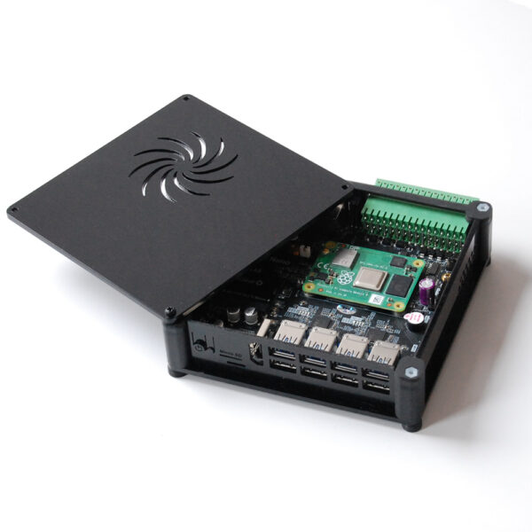

You may order the black case kit with the board together.
You may order the Aluminum heatsink the the board together.
You may also order the board with a Raspberry Pi Compute Module 4 together. If you don’t want to assemble them by yourself, you can also order the fully assembled computer.
PiGear NanoPiGear Nano in the Case

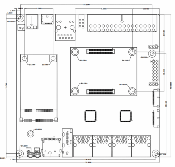

Board Size and Weight NANO-ITX 12 x 12 cm,  150g
