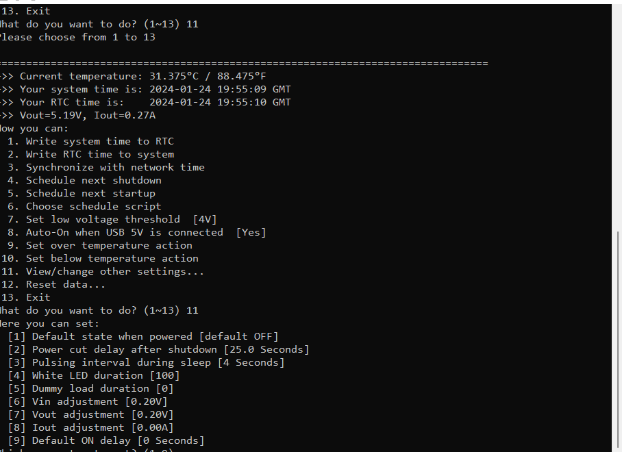

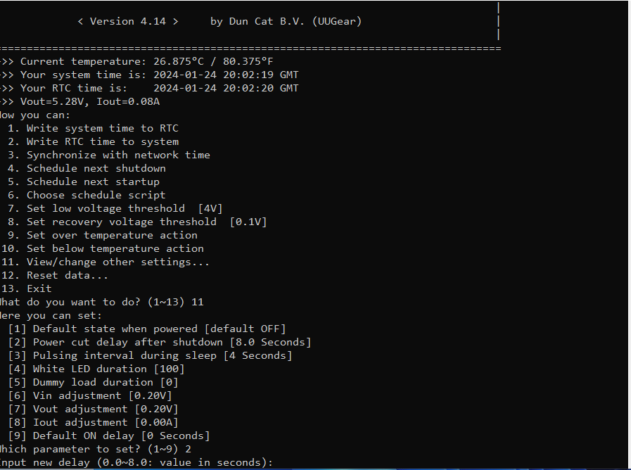

Hi,
Before I could set the Power Cut Delay to max of 25 seconds. Now I can only set it to a maxium of 8 seconds?

Your screenshot shows you have configured 25 seconds for power cut delay.

I had?
Witty Pi 4 L3V7
Seems the other image did not upload. I had uploaded 2.
