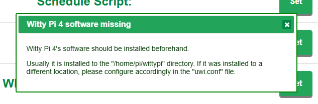

Ihave installed UWI with the script , it looks Ok since the interface is reachable and recognize my L3V7 .
But all parameters dont seem to be  ajustable or taken into account.
I get this message below everytime i'm connecting to the interface.
I have modified the path to the right folder according my RPIe but still dont work
I noticed that i have 2 uwi folder , one at myRPIE/uwi and another at myRPIE/Myspecialfolder/uwi
contening the same files.
I tried to modify both uwi.conf
I tried the diagnose.sh
I have no more ideas

ok i just made a mistake in the path
