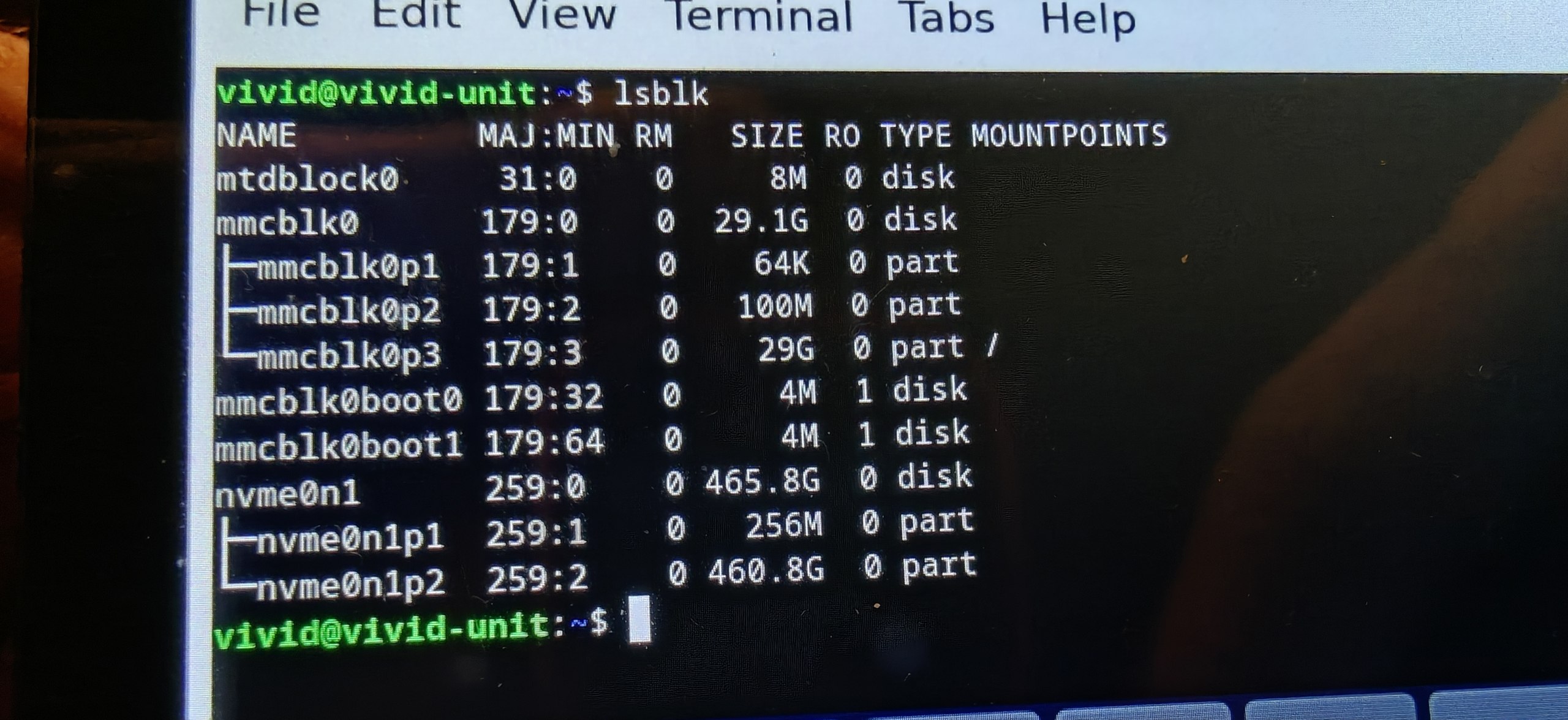

Good morning,
I downloaded the indicated file ( https://www.uugear.com/tmp/rk3399-vivid-unit_20260713.dtb) and successfully completed the steps.(I'm attaching a screenshot.)
Thanks for the prompt assistance and excellent work.
P.S. I noticed that there's already an image ready, updated on July 13, 2026, including the fix. https://www.vividunit.com/download-system-image
