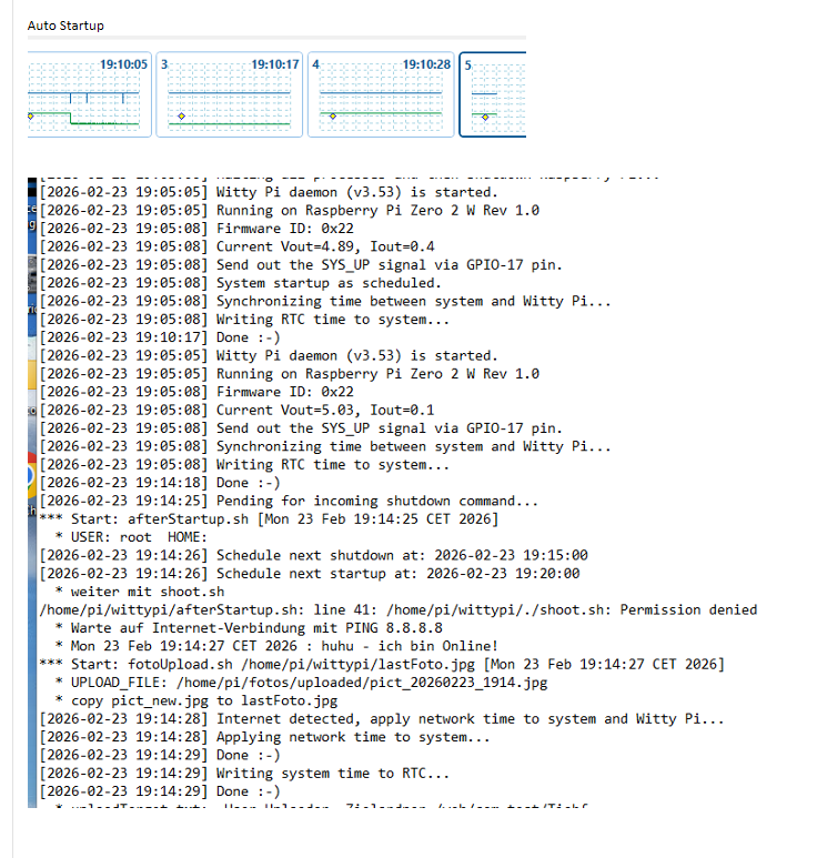

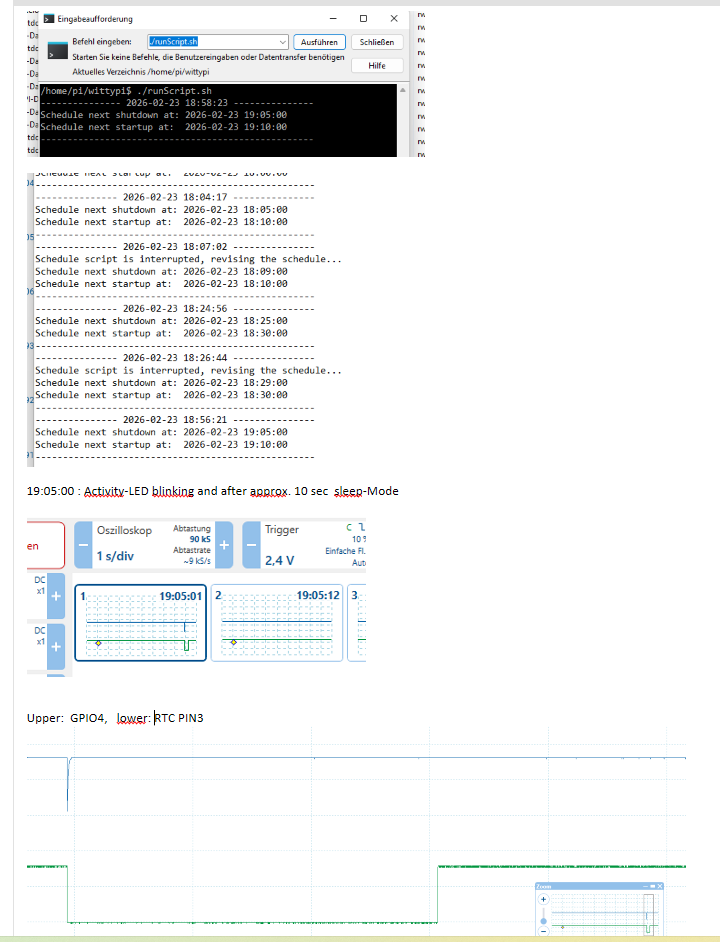

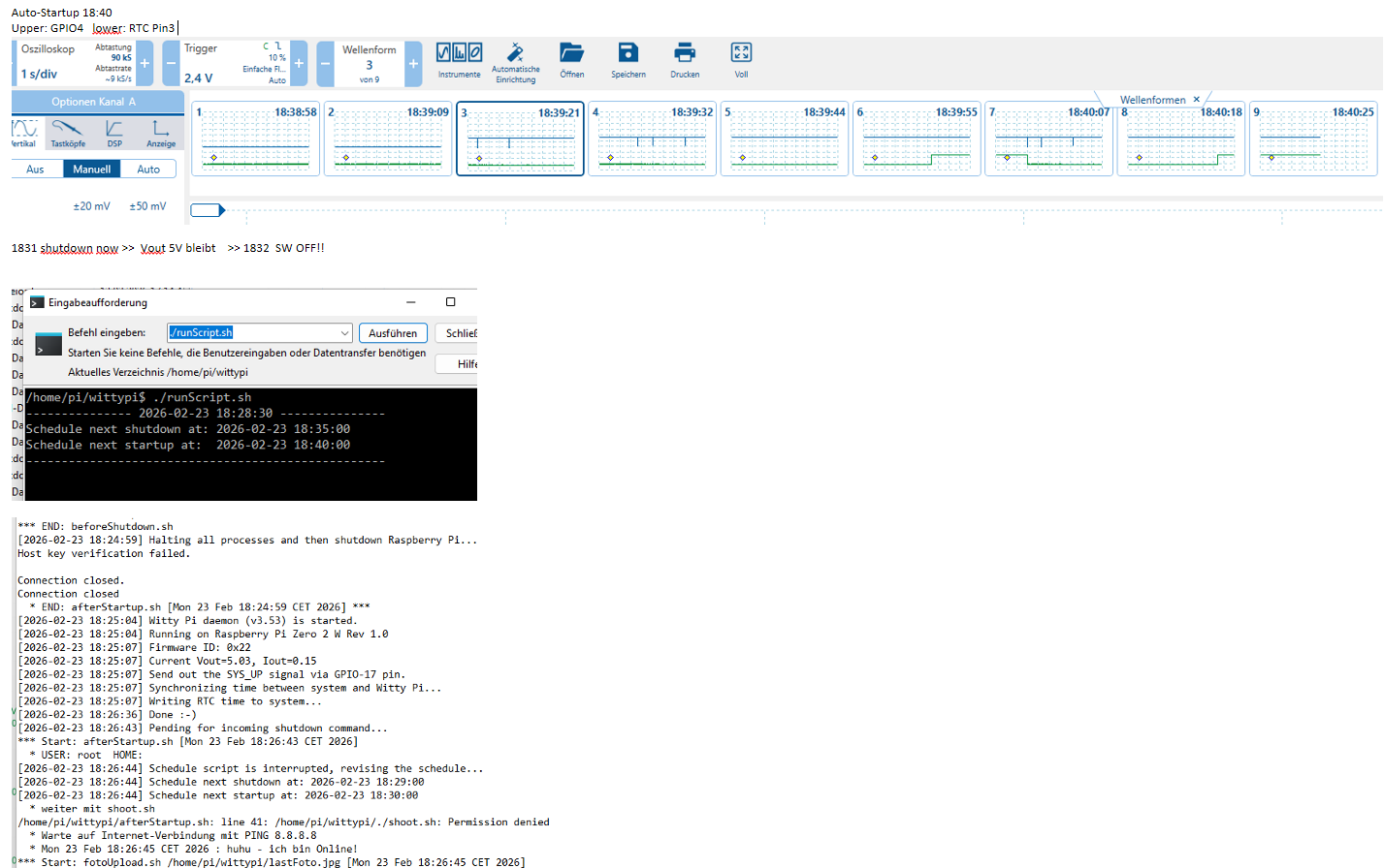

thanks for the additional info.  Using an oscilloscope, I monitored GPIO-4 and pin 3 of the RTC. Interestingly, during auto-startup, short pulses appear on GPIO-4, and I believe these interrupt the startup sequence. See the attachment.

@nokellner the short pulling-down on GPIO-4 is a designed behavior in the firmware.
You may check the source code of firmware here: https://github.com/uugear/Witty-Pi-3/blob/master/Firmware/WittyPi3/WittyPi3.ino
The emulateButtonClick() function will be called when the RTC alarm is detected. For Witty Pi 3, it is impossible to know which kind of alarm (startup/shutdown) occurs until Raspberry Pi is up and read I2C registers in RTC, hence such button clicking emulation will perform everytime the alarm occurs. When RPi is running, such a short pulling-down will be captured by the software (daemon.sh) and shutdown command will then be executed. When RPi is off/booting, such pulling-down will be ignored.
