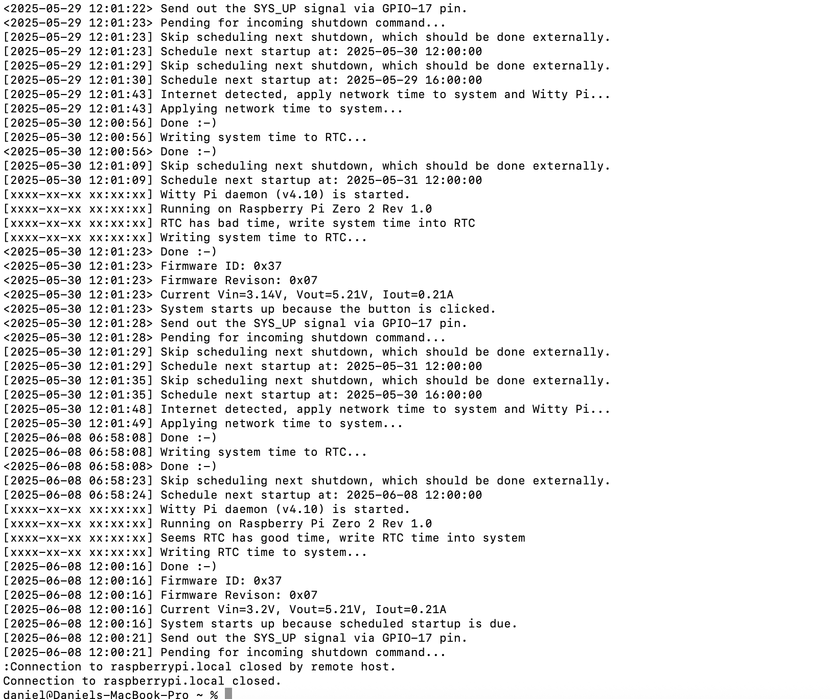

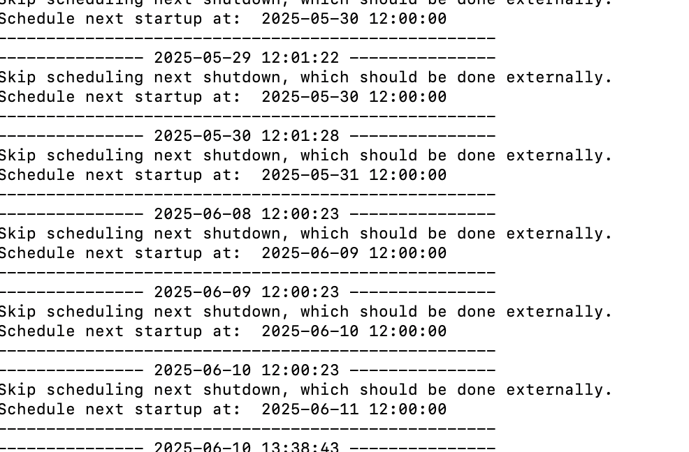

I noticed the schedule script seems to be run 3 times for every boot, and 2 times happened before the Internet time is applied, why is that? Have you modified the software?
The log says the RTC time has lost or is corrupt during the boot on 2025-06-08, the software first wrote system time (2025-05-30) into RTC, and then did an Internet time synchronization, which correctly set time to 2025-06-08.
Something must happened after 2025-05-30 12:01:09, which caused this issue.
I guess you run shutdown command somewhere to shut down your Pi, because I do not see the "Halting all processes and then shutdown Raspberry Pi..." message in your log. If you pull down GPIO-4 instead of run shutdown command directly, the software can at least record the shutdown event into log. I am not saying this will avoid this kind of issue, but it can provide more information for troubleshooting, at least you will be able to see whether the shutdown has been triggered at an expected time.
Now we do not have such information, I can ony tell something happened after 2025-05-30 12:01:09, and that corrupted the time in RTC, so it can not wake up normally.

@daniel-5014 I noticed in the log, that your battery's voltage was rather low (3.14V or 3.2V). This is quite close to the minumun discharge voltage for Lithium battery. You mentioned the battery was full, but a fully charged battery should have voltage near 4.2V.
Maybe the battery voltage drop too much at amoment and the MCU stopped working.
