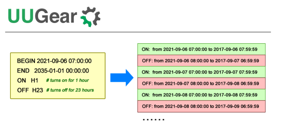

It seems that it schedules at shutdown on the correct day at 6:40, but the startup is the following day after the shutdown at 6:30!
As per the docs on page 19 I would expect it to startup on 22 06:30:00 and then shutdown on 22 06:40:00. I've attached a screenshot of that section. I don't know the diagram states 2021 for start date and 2017 for the end date? I think that may be a mistake.

The behavior you are seeing is expected.
BEGIN defines the beginning of the schedule cycle. It does not mean “schedule a startup at this time”.
With:
BEGIN 2026-08-22 06:30:00
ON M10
OFF H23 M50
the schedule is:
  • ON from Aug 22 06:30 to 06:40
  • Shutdown at Aug 22 06:40
  • Stay OFF for 23h50m
  • Startup at Aug 23 06:30
Since the Pi is already ON when you apply the schedule, no startup needs to be scheduled for Aug 22 06:30. From Aug 23 onward, it will start at 06:30 and shut down at 06:40 every day.
Also, you are right about the 2017 dates in the diagram on page 19. Those are typos and should be 2021. We will correct that in the documentation.
