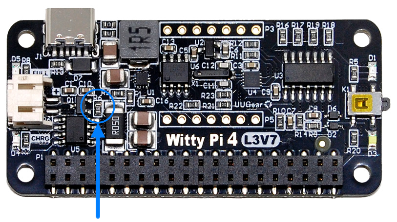

I would like to lower the charging current. I would like to swap ressistor of TP4056. Please  indicate the location of the resistor for charging current on PCB.

It is the R6 on the board, which is 1.2K (for 1A current).
