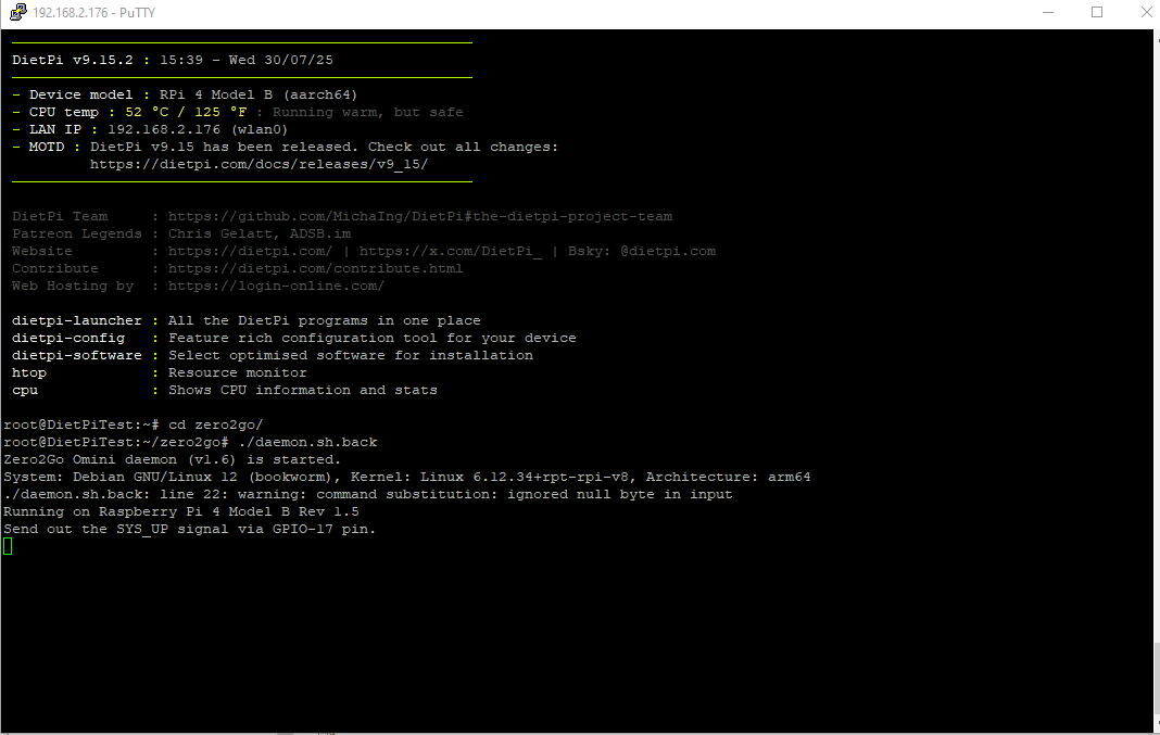

Thanks for the quick reply.
I installed latest version of wiringpi from the wiring pi github repository.
I then verified installation with gpio -v  and it shows V 3.16
I tried running the daemon.sh file manualy. You can see on the picture.
After that the pi went black and also LED of zero2go instantly turned off.
Posted : 30/07/2025 3:44 pm
