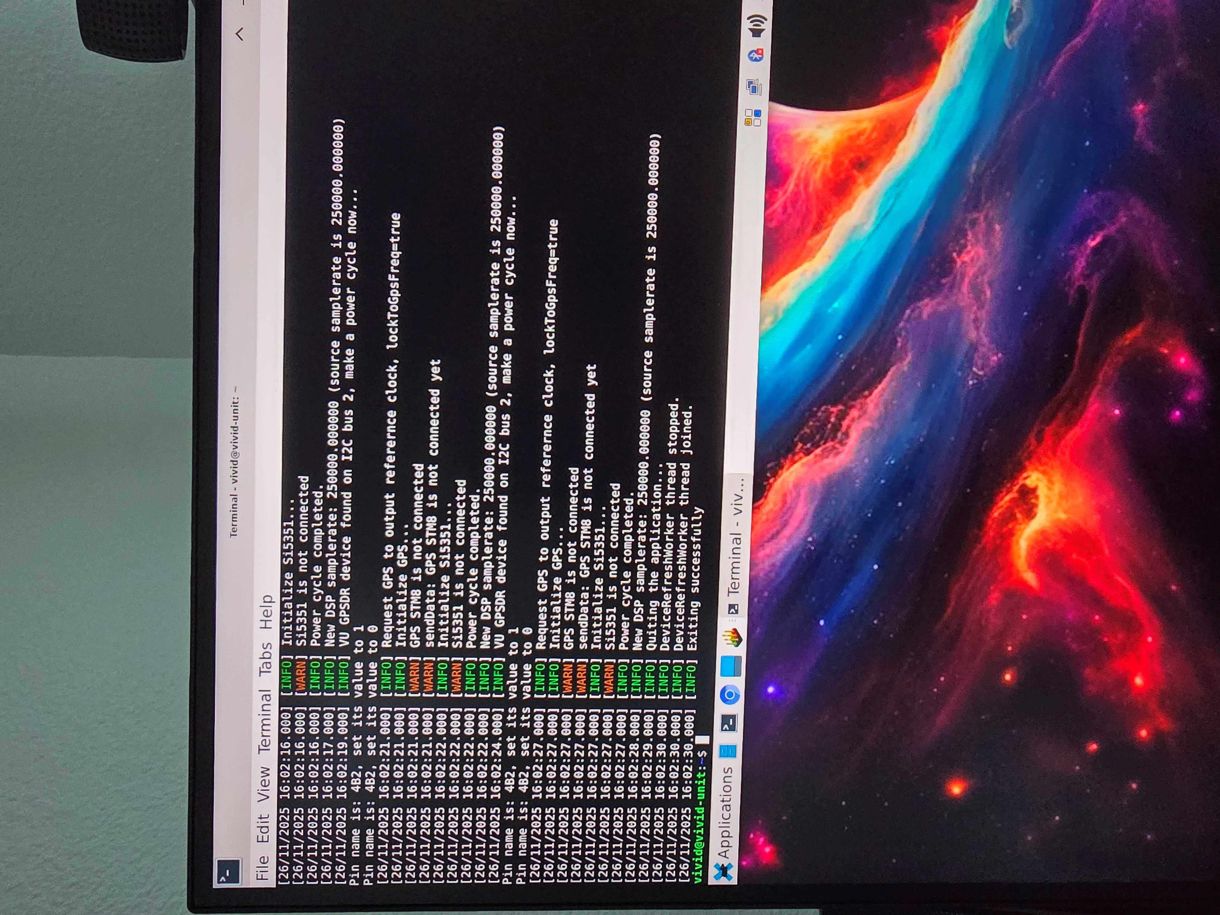

When I run GPSDRPP from the terminal emulator the script continues to recycle the power and shows warnings that GPS STM8 is not connected and tries to initialize the Si5351 and says it is also not connected.
When I start from the applications menu, the GPSDR++ loads fine but will not play.
Do I have a defective VU GPSDR board?
I've Re installed all the software, still not working
See attached picture of script

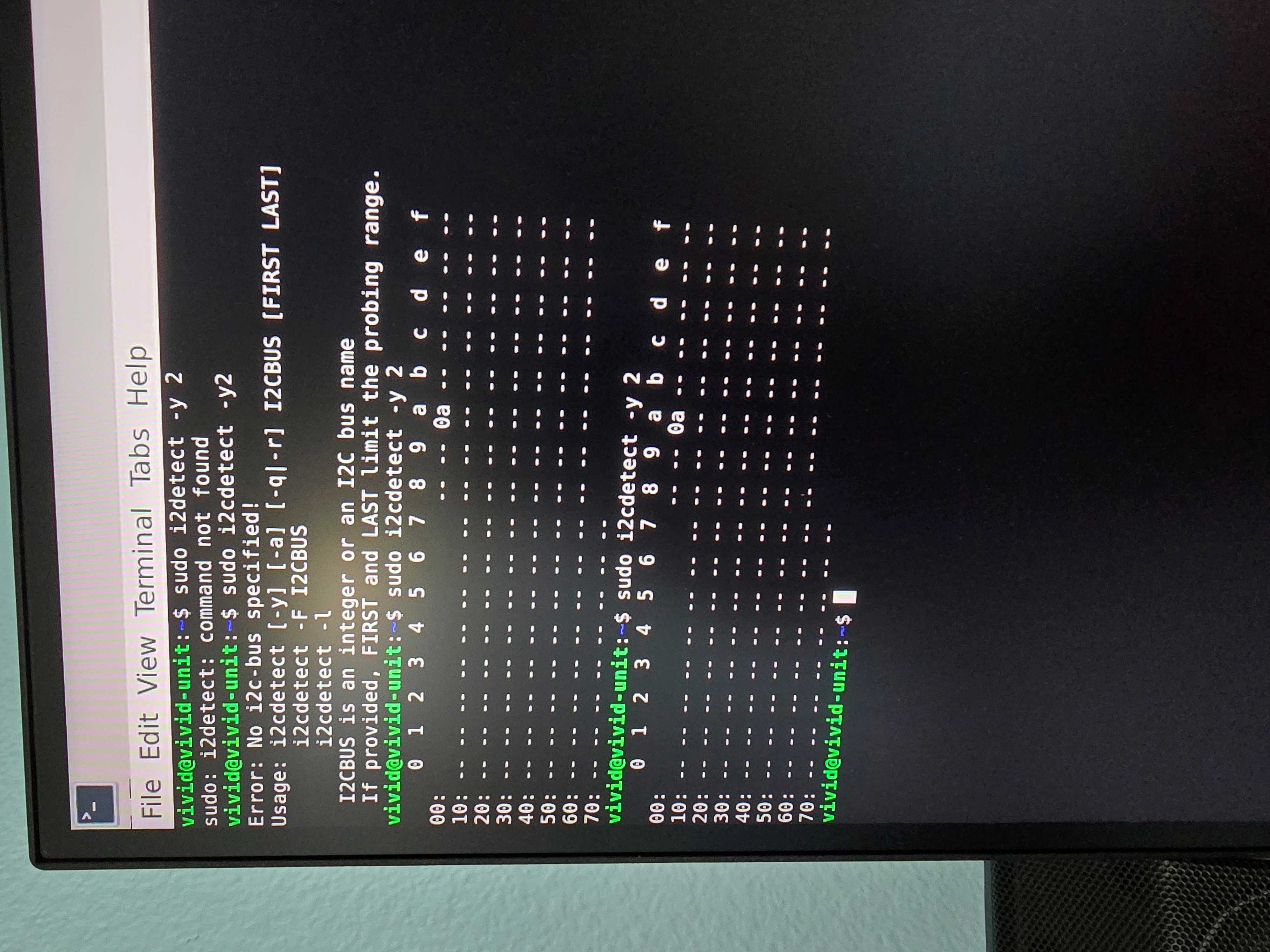

the first sudo detect is before starting GPSDR++
The next one is after starting GPSDR++
see screenshot attached

(@test27)
Posts: 23
Eminent Member Customer
Posted : 27/11/2025 10:33 am
(@test27)
Posts: 23
Posted : 27/11/2025 10:47 am

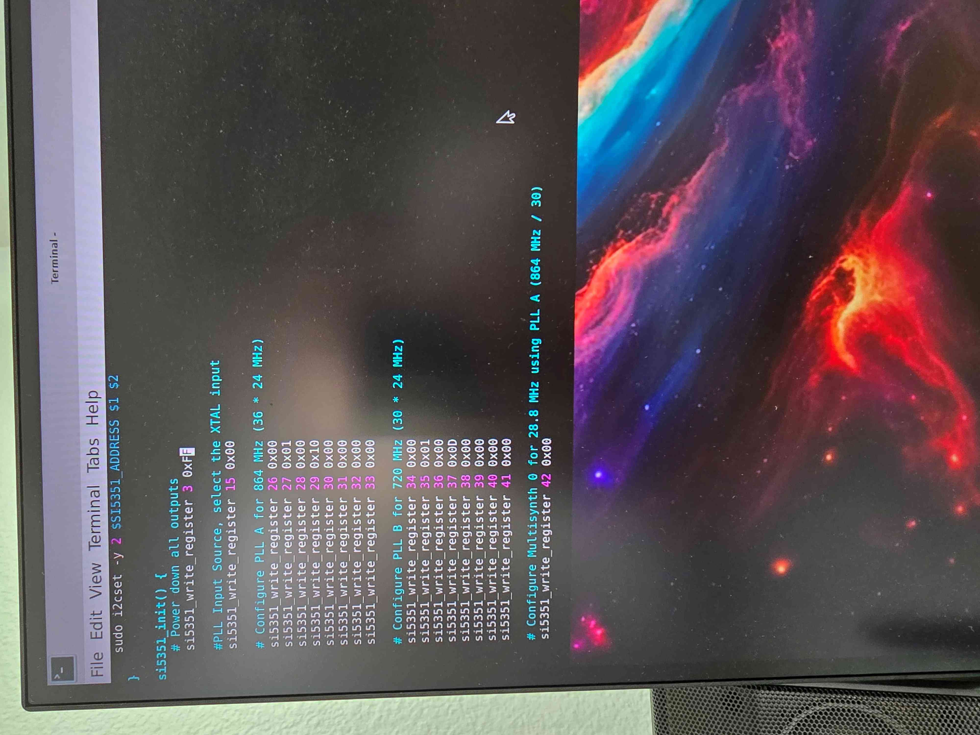

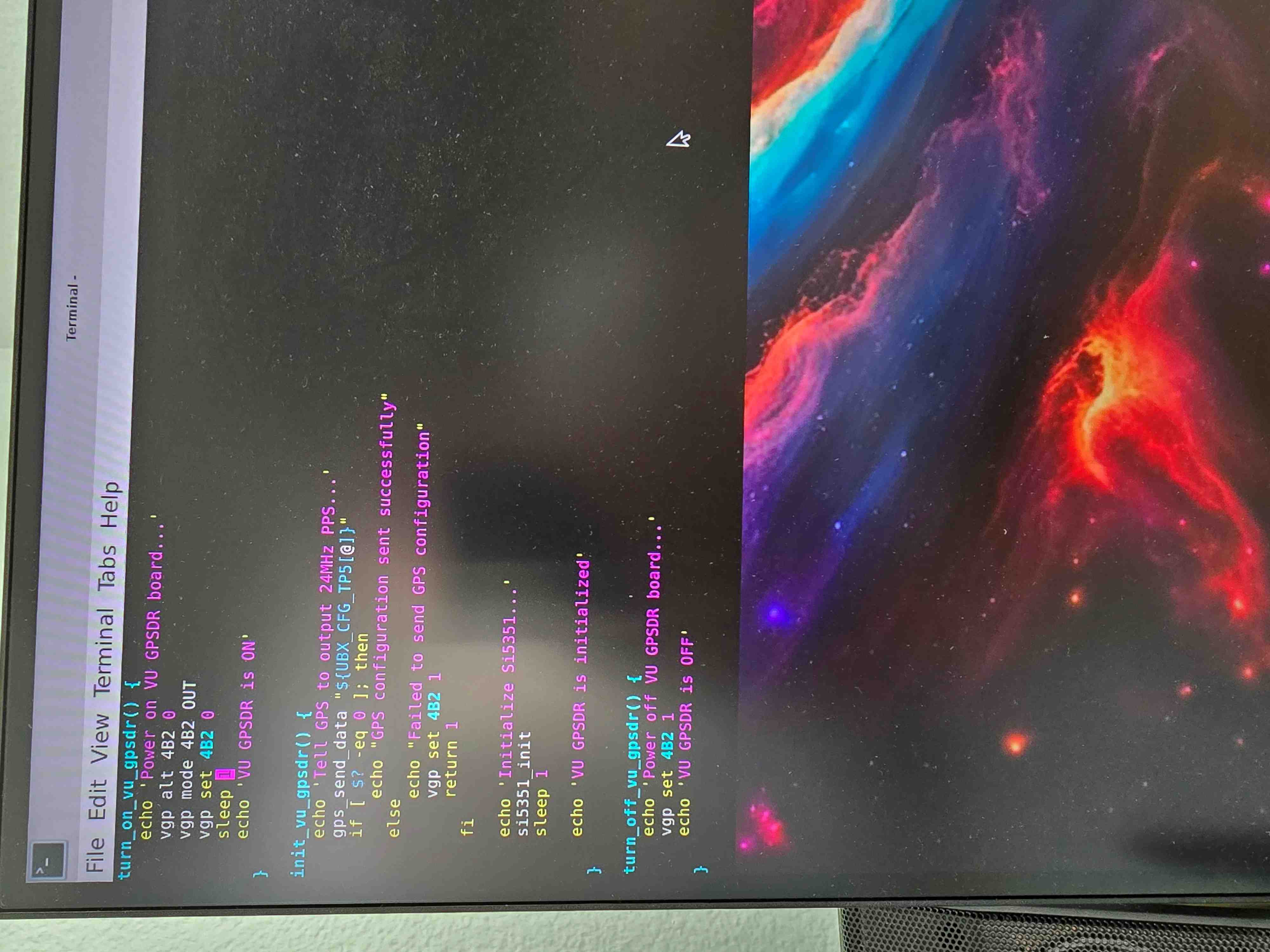

Posts: 838
@test27 thanks for the screenshots, but I mean to run the script and show me what it outputs, instead of showing me the content of that script.
After downloading the scirpt, you can use the commands below to make it executable and then run it.
chmod +x ./gpsdr_step_by_step.sh
There is no need to show the output of gpsdrpp again: I already see it says the device is not connected, but it doesn't give any detailed information.
