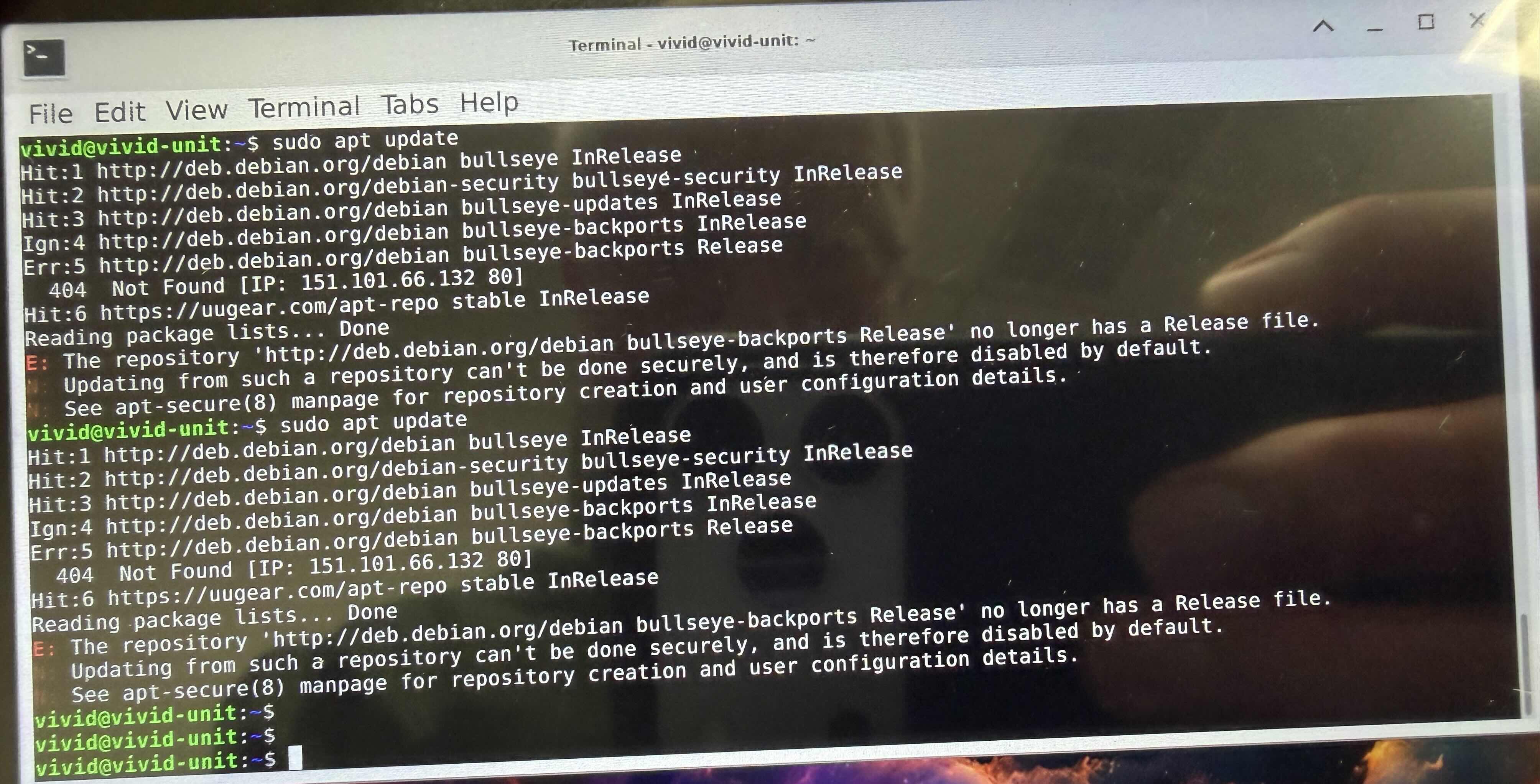

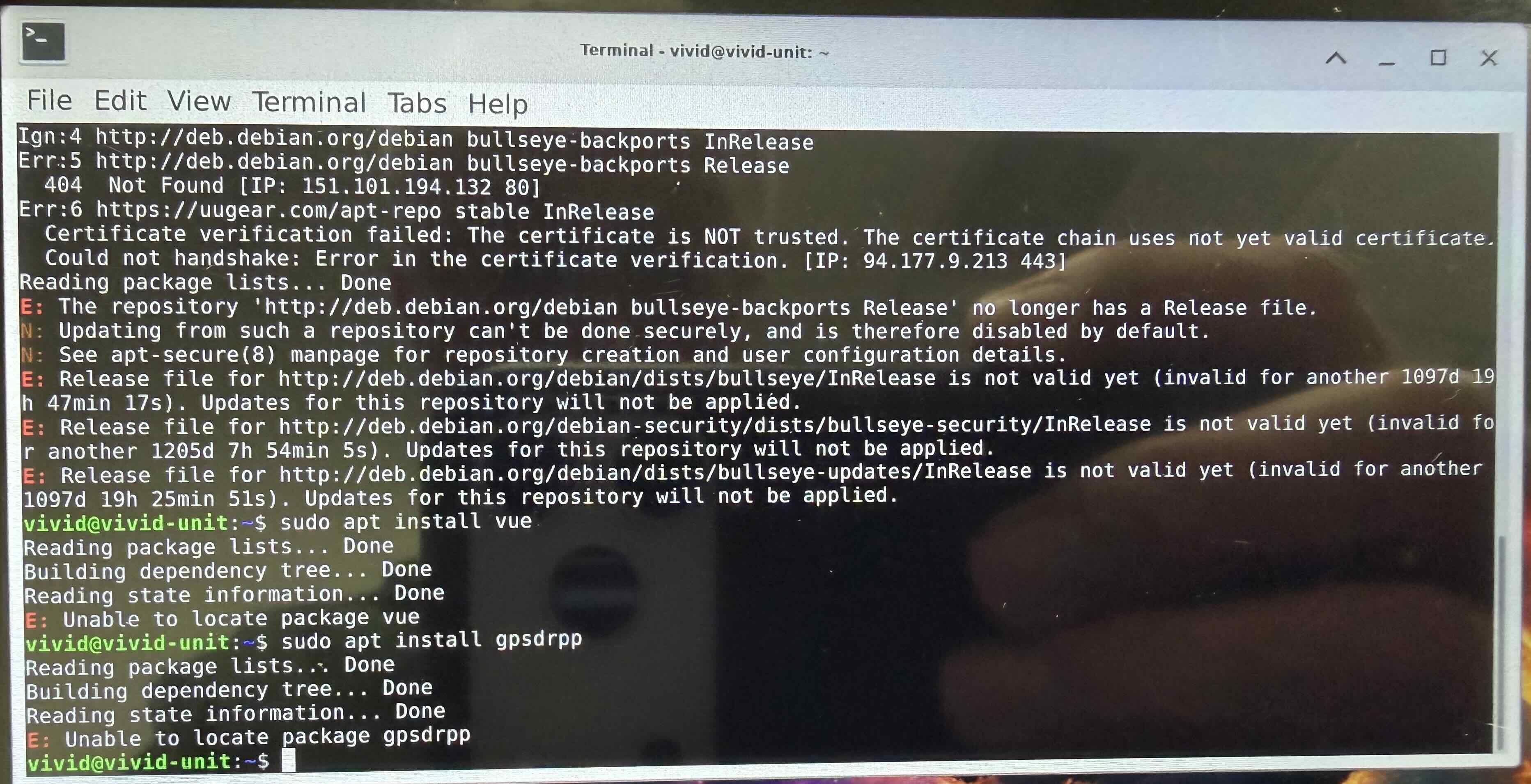

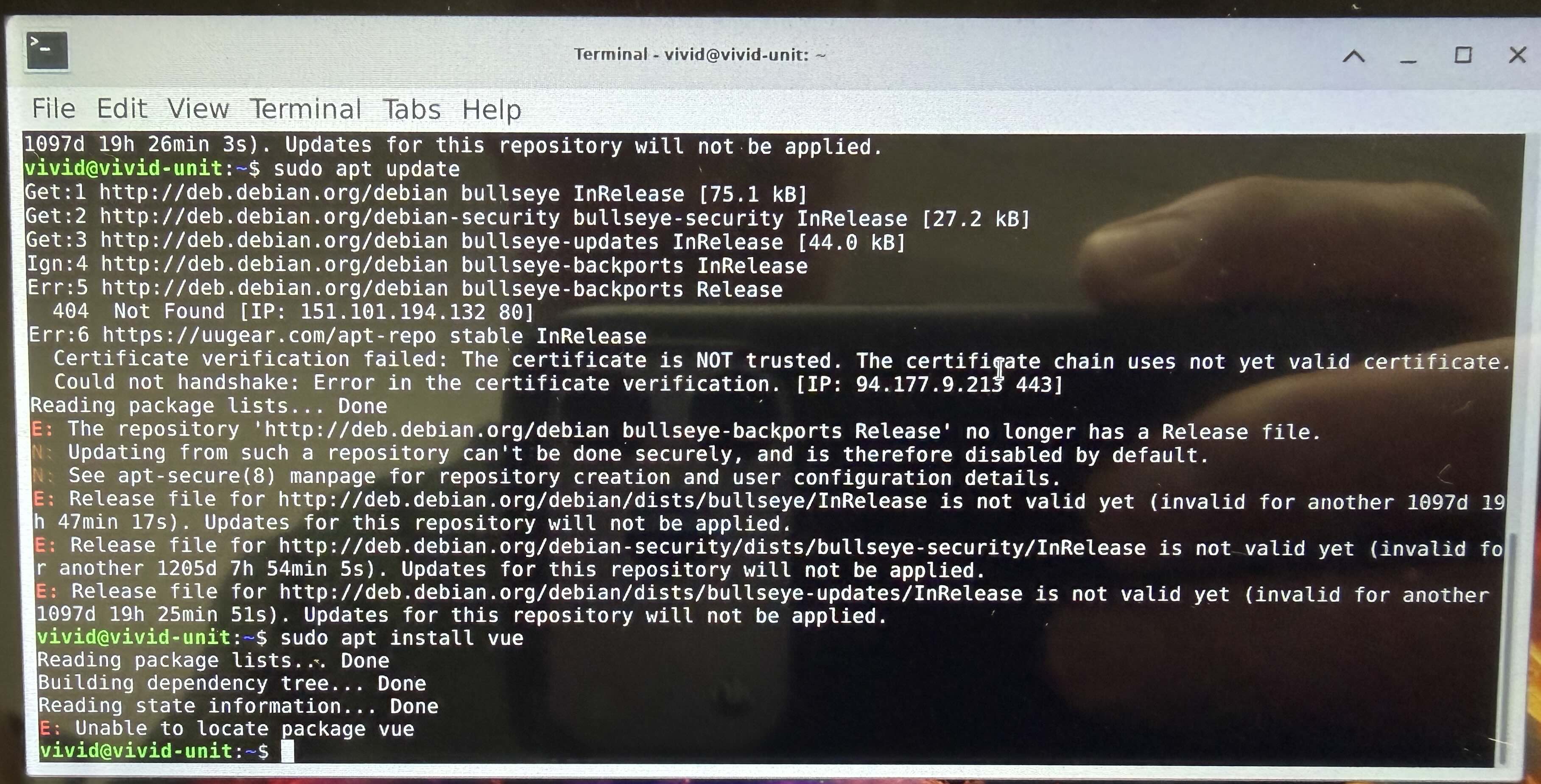

There were many failures attempting to perform the initial setup.  I'll attach photos here.  It seems there were missing packages, invalid certificates, and other issues.

@admin Here's the second of three images captured when performing the initial setup of the Vivid Unit and GPSDR:

@admin Here's the third of three images

I'll try sending slightly more compressed versions of the screen shots so you can see some of the errors that occurred during initial setup.

@admin Screen shot 2:

@admin Screen shot 3

Please note that these screen shots were from the initial failed setup.  The device is completely unresponsive now

@pete-norloff In your screenshots, the only important error message is this one (other messages are complaining the system is too old):
Err:6 https://uugear.com/apt-repo stable InRelease
Certificate verification failed: The certificate is NoT trusted, The certificate chain uses not yet valid certificate.
Could not handshake: Error in the certificate verification.
It says it doesn't trust the certificate used by uugear.com (our software repository is hosted there). This issue is also mentioned in the review on rtl-sdr.com, and the solution is to run:
sudo update-ca-certificates
Strangely we have never reproduced this issue here in the Netherlands, but I guess the solution also works for you.
Howerver, I don't think this issue will brick your device. In case of the certificate does not get truested, it just can't download and install our software hosted on uugear.com, there is no way it can still write something to the kernel partition and brick the device.
Posted : 26/11/2025 7:58 am
