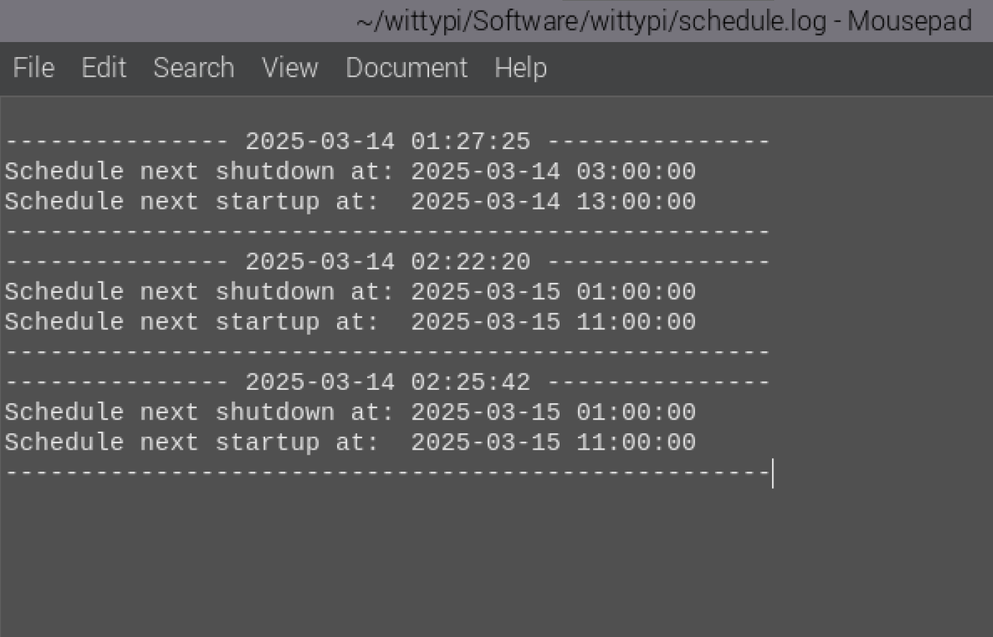

I'm having a problem with my WittyPi 4 Mini's scheduling where every time it cycles to the next day the next shutdown and startup is moved forward by a month, I have tried looking up this problem online but haven't found anything so if there is a simple solution or something I'm blindly missing please let me know, and excuse my ignorance.
Example:2025/3/15 would switch to 2025/4/16 the next time it starts up.
(schedule.log does not show it updating to the "next months shutdown". )
As you mentioned the schedule.log doesn't show it, how did you know it scheduled shutdown to the next month?

@rasberie-bie UWI gets data via functions in utilities.sh, so eventually it is from the same data source. The data logged into schedule.log is more trustable.
I am not sure, but it could be data transmit error, I2C readding error or bugs that caused the incorrect data shown on UWI.
